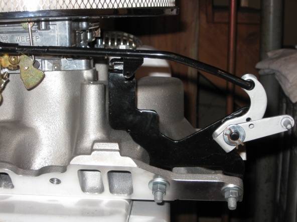

There's nothing wrong with the parts you picked . It just take's a little tweeking to make them work right . Here's a shot of the throttle bracket that I modified for my small block . As far as the by pass hose go's ? I'd have to see what your dealing with but I've run after market intakes with AC in the past . I hope you did'nt get talked into putting to big a carb on that small block . Bigger is'nt allway's better .

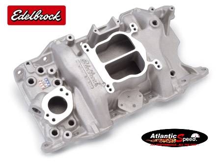

If you have the later style jap AC compressor ( mid 80s-93) there is only one aftermarket manifold with the offset water neck, that is a standard Edelbrock Performer (pictured). Note the offset water neck. 4 barrel engines use a taller throttle cable/kickdown bracket to clear the runners in the manifold. Not hard to find if there are any decent junkyards near you. If not, somebody here or on the FABO site can surely help you out.
Hope this helps, Alan
