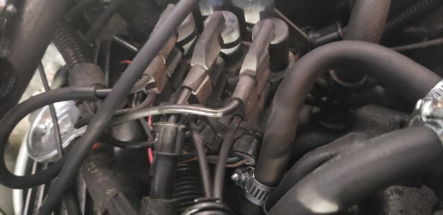

    I need some help here I have a 1989 dodge d150le with a 318 tbi I put headers and a cam in it as well as deleted the factory smog pump having issues with truck being boggie on bottom end and pretty sure its vacuum related I need to know what the vacuum sylonode do and if they can be deleted they are normally mounted on passenger side valve cover.

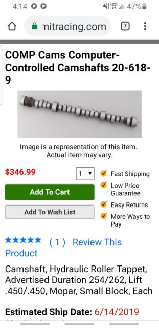

    New issues - always, always, always look at the last thing you did before you start changing more stuff. Was the cam degreed?

      The cam is and is a computer controllable cam

      But was it degreed on install? I may be mistaken but I seriously doubt any 318 tbi has a computer controlling your camshaft. If it does, you have an extremely exotic setup and I wouldn't expect to see any of the vacuum sensors and the like in your original question still in the engine compartment. That is a chain driven camshaft and chain driven camshafts should be degreed on install to ensure the proper valve timing. Many have done the dot-to-dot alignment with the crankshaft/camshaft gears and had no issue, others have had problems with mismarked gears and such and that won't be found without degreeing the camshaft.

        Computer controlled timing. Do not confuse that with computer controlled cam timing. My 89 - 360 still has a plan old timing chain setup.

            I did finely figure the vacuum system out by getting a diagram and re doing it all most of it was wrong when I started truck runs great now
