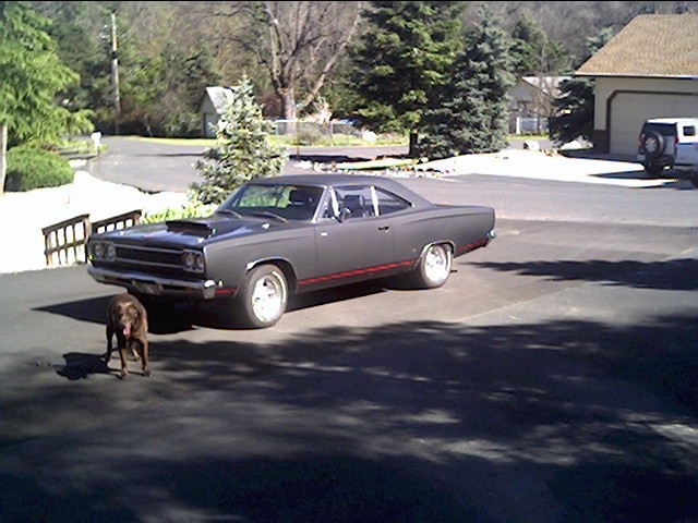

I wanted to say "Nice Cuda" too Bushwaker
I have a 68 RR, ongoing project
I've had a bunch of different Mopars & various muscle cars or race cars too
