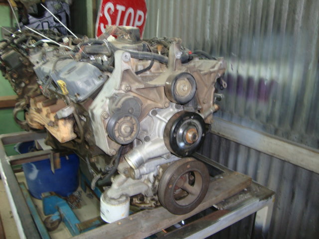

the truck v10 is not a viper engine , viper only shears the engine cubic inch size . i had two truck v10s and no takers . so i peeled them and scraped both of them . kept the rocker gear down to the roller lifters .

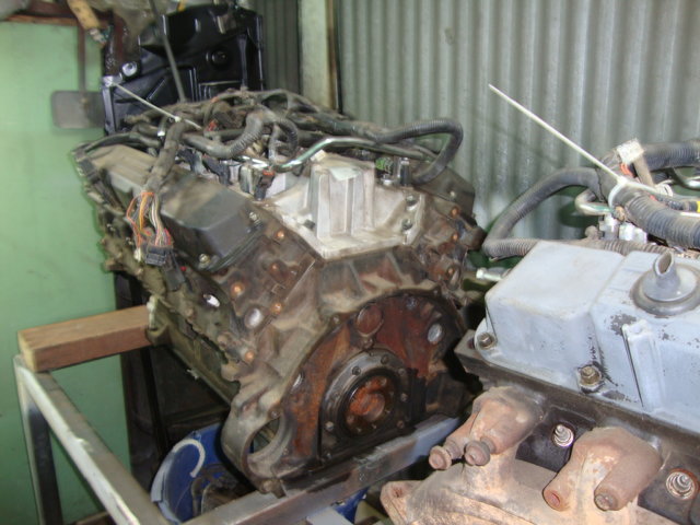

i got those off c/l . but the bellhousing pattern on mine were same as the cummins with a hole in the block for the starter to mount . not even close to the la or magnum bell pattern . the some of the internals are magnum , but oil pump is up front . no dizzy , just coil packs .
