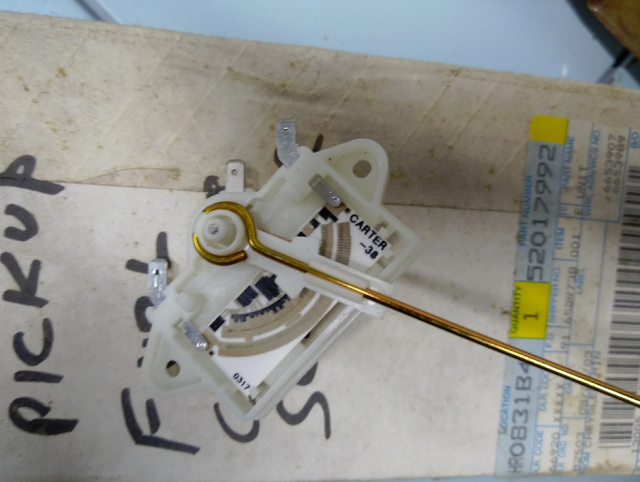

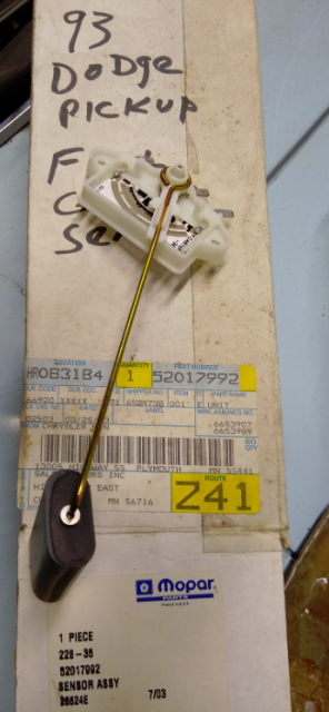

I believe the way the sending unit is mounted in the tank is the problem. My 89 has a hose clamp shaped like a V to pull the two together. The later models have a threaded ring the screws on to squeeze the two together.
This is what mine looks like.
Ok i cant remember exactly what mine looks like. I dropped the tank 2 years ago. But that really is all i was looking for because my pump is good. Where could a guy find one of those? I do have the pump assembly out of a 2nd gen if that would work.
If I can find mine I would put it in a box and send it to you. It worked when pulled. We broke the line fittings off trying to remove them. Pump Even worked.
Ok cool. Thanks. Let me know what i would owe you for everything.
