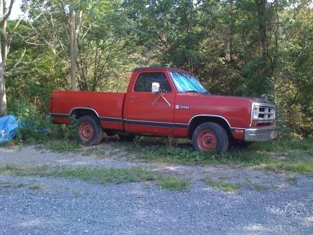

My 87 D100 regular cab short bed - slant 6 904. My grandson bought the truck minus engine and transmission. I gave him a 72 Super Six-equipped slant/904 so he could get it running. Him and his Dad got the motor in it and messed around trying to get it to run right. I told my grandson if he ever wanted to get rid of it, I'd take it off his hands. He got tired of trying g to get it to run right so ended up selling it to me. Looks like the problem was making it run with the original computer. I'm in the process of converting it to HEI and adding a new exhaust system.

I don't think my grandson or his Dad even realized the truck had a computer (hidden behind the battery in a recess in the fender). Looks to have been maybe a Lean Burn as it has 2 pickups near the distributor. The motor I gave them was already converted to Mopar electronic ignition so they tried both pick-ups (separately) and got it to sort of run with one of them - most likely the run side. The HEI ought to solve the problems. RE: older harness - there's not much of anything old around here - all been crushed. I'll work with what I've got. Still a pretty sharp looking truck!

Got a brand new exhaust system on it - 2 1/4 ID from the manifold all the way back. Hi Flow cat (VA inspections where I live visually inspect for a cat); low restriction muffler - the ol' slant ought to breath pretty good to go with the 2 barrel Super Six.
