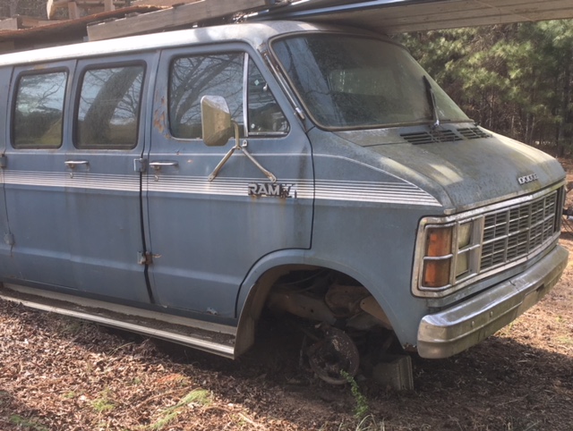

    296845AA-6DD8-47C4-914A-317ADF2D170A.jpeg 2D9BB883-DCFC-4B2D-BB30-9CD15EFC7BC3.jpeg I finally installed some 5 on 4.5 brake rotors on my 87 D150. I used a pair from an 84 B150 Dodge van. I was reading several threads on Facebook. A lot of misinformation on there. Several guys where saying that all you needed to do was get some early rotors. So I installed these on one side only. Found a good rim & tire & everything seemed to go well. Drove a very short distance at 35 mph. Felt good. No shimmy or wobble. No brake pull. Came back to the shop & checked the lugs still tight. So did I miss anything ? Anyone else done this conversion. I’ll do the other side if this is all ok

      I am guessing the bearings are the same between the two rotors, sounds really promising

      The inner bearing is different.
