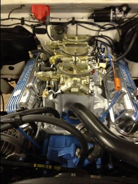

new motor setup is going in as we speak , went from a small block to a 440 based 512, will take some pics
