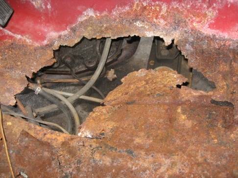

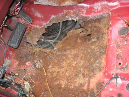

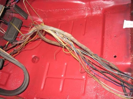

IMG_0996.jpgIMG_0997.jpgIMG_0998.jpgWell post some pictures of what you've got so we can tell how bad it is and maybe we can steer you in the right direction . At the very least it would make a good restoration thread like Gray said and maybe we can help you along the way . I believe I can get left and right floor pans ( but not full floors ) and rockers . "maybe" cab corners . But I'd have to check my sources before I committed to anything . I don't have any measurements but here's a before and after shot of a 4x4 floor pan that was done a "while" ago . I used a pan that was meant for a Two wheel drive but you get the idea . This was just a work'in beast so I didn't care about making the repair invisible .
I have an 88 dodge power wagon and my floors are worse than that lol, bear that turned out perfect, I seen floor pans in lmc catalog, but I also need 1 brace under the floor and I just found where I can get them.
Just as long as you don't need a transmission tunnel . I haven't found a supplier that makes whole or complete floor pan's yet . Or just the tunnels . I've got the LMC catalog too but I haven't bought anything from them "yet" . So I can't say how there quality is as far as body panels . I'm kinnda picky on who I use for suppliers for aftermarket body parts . If I'm going to use something or sell something that someone else made then I look at it as my name is on it . I've gotten floor pans and patch panels for some people that were so thin or didn't fit right that they were sent back that same day . That brace your talking about ? Let me guess , It's the body mount support under your left foot ? ... Oh yeah , Thanks for the compliment on my floor job . That's how I do a floor on a driver or in this case my work beast . If it's something like a show car or truck then I'll hide were I welded it and try to make it look like I was never even in there to began with . You'd never now that , that was a two wheel drive pan in a four wheel drive truck would you . lol Ooop's I let out my little secret . Don't tell anyone . lol
my tunnel is perfect, yes its the floor brace for left, right one fine but I found place u can get them new
A little helpful hint . When your about to put the floor pan in on that side . Mount the body mount bracket to the body mount and frame . Then lay the pan down and outline the bracket on the bottom of the floor pan . Then drill a few holes on the pan that will line up with the flats of the bracket . That way after you weld up the pan you can weld up the bracket with some rosebud welds . If you look at the floor I did , that bracket should be right under the hole were the body plug go's . That's how you get to the top of the bolt for the mount .

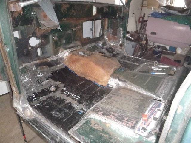

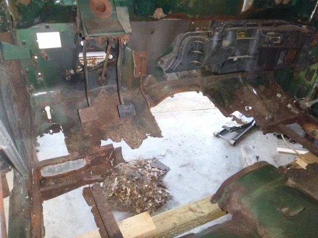

My `76 clubcab was really bad, just take as many measurements as you can before cutting it apart and always fit the door before welding anything.
The biggest problem with these trucks is replacement parts are limited and most falling short of repairing the whole panel. I needed to patch area's around the floor that the replacement floor didn't fix and once you pull a rocker you find all kinds of carnage that cannot be bought as not to mention the rockers are sub par leaving the tail end to be reused. It will require a lot of patience!
