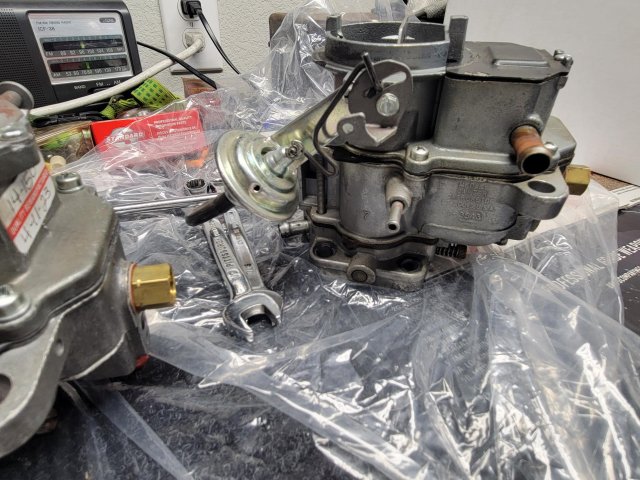

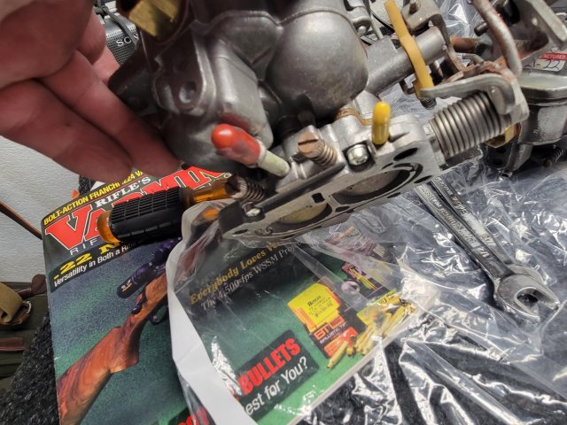

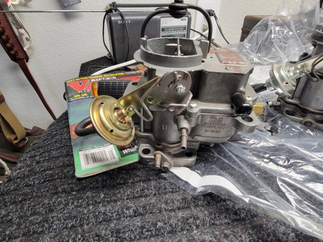

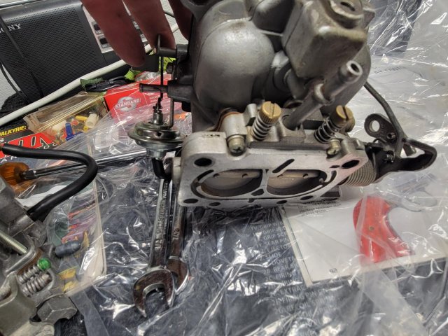

I put on a new(rebuilt) carburetor on today. It is a little different and I am not sure why.
Different as in how?
Probably a different "carb number" than what you had. Same model carb but they can have different numbers of vacuum ports.
the top picture is the old carb and there is no attachment on the bottom for another spring. the second picture had an extra vacuum connect that I plugged, the third picture shows no vacuum. I need to attach the other picture lol
