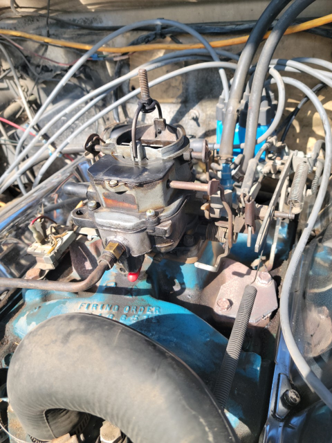

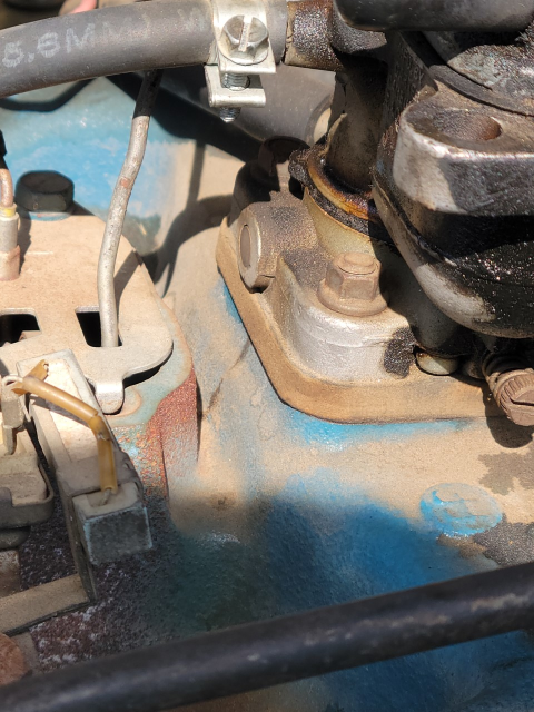

Here are the pictures of the carburetor, I went out to start it and it started still with no issues. I kept it running and when I let of of the gas pedal, it would stay running then kick down in rpm and start to stall. Then I would give it gas and it would come back to life. On the 3rd picture you can see were the gas is dripping where the shank/bar goes all the way through. I am starting to think that the carburetor is having too many leaks. I would try and spray wd 40 around the carb but I have no one for the last 3 weekends to help keep it running while I shoot some spray around to see if the idle goes up any. I have been Texas now for a year and the carburetor was working great and when I drove from Cali to Texas it was none stop other then the gas stations. My fuel gauge doesn't work and hasn't for like 15 years so I just keep track of how much I drive and fill it up. Now coming across to Texas I stopped about every150 miles or so for fuel and then back to driving I went. It took about 30 hours and and had no issues at all. Looks though with all the leaks it may be part of the cause, anyways.

Sounds like you have more than one issue. If it won't start at times while spraying starting fluid in it that would suggest no spark.. possibly fowled plugs (flooded), trying to stall while running however sounds like a tuning issue. I don't see those leaks being the problem however dirt could have made it's way into the carb while replacing the filter? There's several things that could cause these issues so it's not a bad idea to just go through the list, confirm ignition timing, check idle mixture screws, idle speed screw, proper choke adjustment (once the motor warms it will drop the idle speed), check for vacuum leaks.
Unfortunately intermittent starting issues are a PITA to troubleshoot, you almost have to wait until it refuses to start before you can even start tracking it down. Something you could try is attaching a meter to the coil feed wire and mounting it where you can see it that way whenever it does it again you can instantly see if there's voltage?
