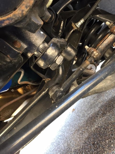

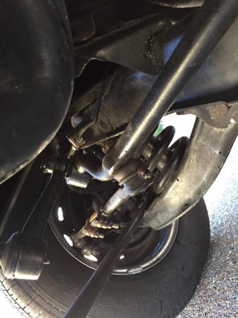

    Hope these help. If not, let me know and I can take more.

    Okay, well, I couldn't get at the 79 for comparison. (I'll upload a couple pics later for 7) But, all things being equal, I did check my 83 and 84 and if I'm right, your drag link may well be reversed. It's really easy to do if you rebuild the front end - I've done it. The only visible evidence is the angle of the tie rods with respect to the drag link, and yours is different than mine. That's what I finally spotted when I had two of them side by side. I'd suggest you find a chunk of gravel road and try some turns - see if it "plows" and I'll bet it does. You can check it at low speed, (barely moving and up to half a rotation on the wheel), with the window down to hear the funky sound the tires make on the gravel.
