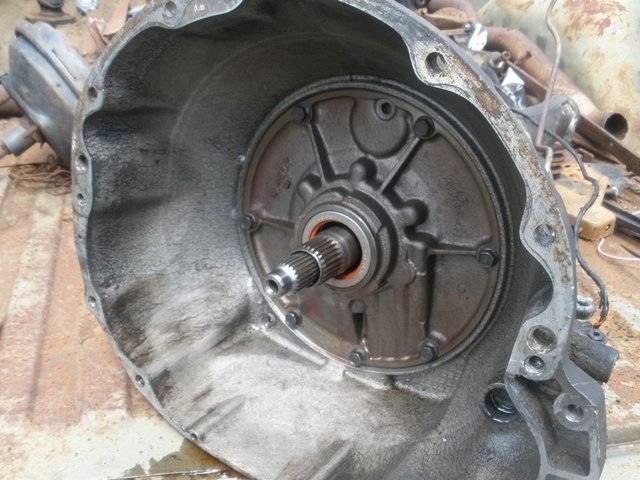

Does your transmission have the 5/8" input shaft pilot tip? If it does it's a lockup. If it's splined all the way down the input shaft it's a good old non lockup.
A picture will talk by herself. so the 727 is a lockup one. and there is a sticker Lockup LS on the converter.

My 727 is with a long tail shaft and whitout removing the torque converter you would not notice it's a lockup one..And like you said i am going to upgrade the shifting by modifing the valve body.Guess it's the best way....

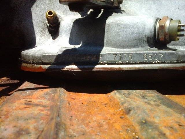

My Chrysler trans book goes to 79. If you want to post the number one the pan rail on the shift side can tell you whats supposed to be in it.
