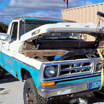

Preparing to pull engine/trans as one.
Already pulled rad, all engine accessories,
shift levers, access plate above trans, exh manifolds, dist, carb, water pump, Unbolted trans mnt & trans mnt x-member.
Question: do I need to pull the x-member under the trans(4 bolts per side) I hope not, but not sure.
Thanks
Picture of cross member under trans.
Not sure if i need to pull this X- member or not.

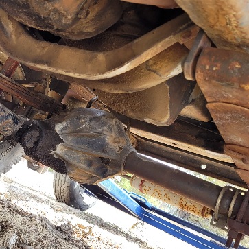

Thanks. X-fer case is separate from trans, so no problem there. (Pic,three drive shafts) I think I'll need to scrap intention of pulling both eng & trans as one. it seems Id need to drop the trans down 3" to clear firewall sheet metal (see pic). I'll try separating bell housing from trans, then pulling engine & trans separately. Since I can only rotate crank ~180 degrees, I'll need to slide clutch plate off splines without removing clutch housing. If this is possible, not sure, I think the engine will come out with some effort.
Then trans, I think, can be lowered out toward the back. By easing the trans down & rearward, that shifter mount(?) may not interfere with sheet metal? suggestions welcome.
Thanks, Dan
If you separate the bellhousing from the engine or the trans from the bellhousing, the engine should come out. The input shaft splines should slide out of the clutch disc
