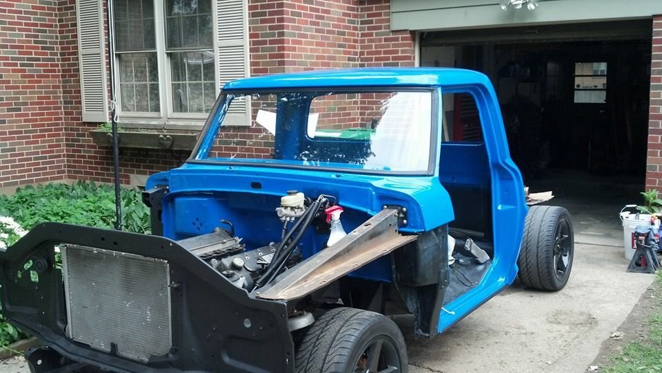

Bought from a friend years ago, the past couple have been busy doing a frame off resto mod/pro tour build.
My buddy with the truck before I bought it.

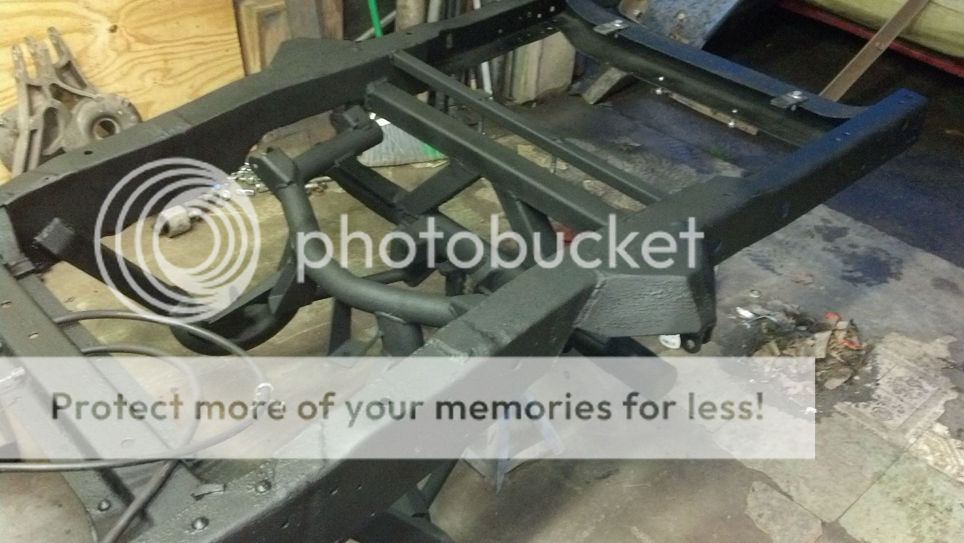

Replaced both floor pans, cab mounts and the roof skin.... Cut out the front suspension and replaced it with a Crown Vic IFS, replaced the rear with a Cobra IRS, dropped in a 4.6, 32V, T45, 4.10 gears. Full Cobra brakes.
Currently finishing the IRS.
