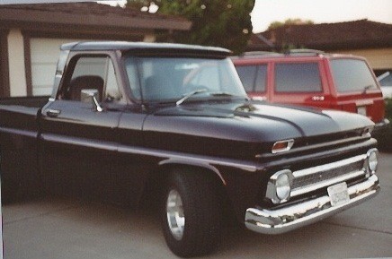

      My `64 as done in `93 Pic test...
      • Like Like x 1

        That's a cool looking truck.
