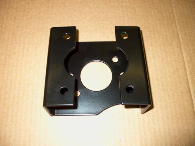

    Jim welcome to the site, I`m a newbie here as well but not to 60`s chevy trucks, you can use `67 to `86 chevy entire front cross members complete, just need to drill two new holes for the exisiting bolts in the donor truck, grab everything, power steering, column, master, booster. You`ll need to order the front frame plate to reinforce the left frame horn under the steering box from LMC, Chevy Duty, CPP, The front sway bar anything and including a one ton chevy will bolt up to your truck, for most the latter is sought after, just grab the links and mounts, replace the rubber and your done. You`ll need to build an adapter plate to position the booster in the right place so you wouldn`t have to drill new holes,( as shows in pic) and lengthen or shorten your brake pedal rod as needed to get full pedal travel ito brake cylinder. good luck [​IMG]

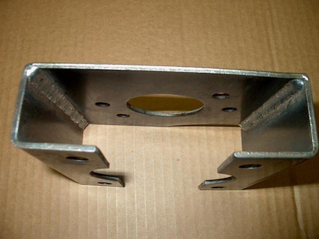

    Not sure what happened but my thread disappeared, anyways grab the entire front cossmember complete, you`ll need to drill two new holes to install, grab everything from the donor truck, Master, booster, prop valve, column...( most people want the 67 to 76 column Cleaner looking) steering box, you`ll need to order the reinforcing plate for the steering box to strengthen the frame LMC, Chevy Duty, CPP they all carry them, You will also need a booster adapter to make everything line up as seen here, just makes life easier...the only other thing is that the brake pedal rod will need to be lengthened, also note GM had two sizes of discs, one inch and heavy duty 1.25 ...... just for your info. Brake booster adapter shown. Good luck with your project.
