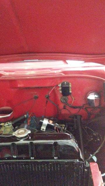

I apologize for having to ask this question. But I cannot find the ballast resister. My FSM makes no indication of one either. So where is it within a 57 D100 - 6 cylinder? I do not see it near the coil or on the firewall anywhere. In my other vehicles, the resister was in clear view.
I also have another question. What is behind the chromed item in the upper right in the picture? I have tried to remove it and am not sure how to do so. I did not want to go any further without checking with you all before I destroyed it trying to remove it.

Flat head 6 and 12 volt systems may not have been. 6 volt systems required no resistor.
