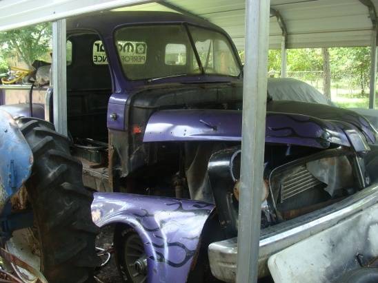

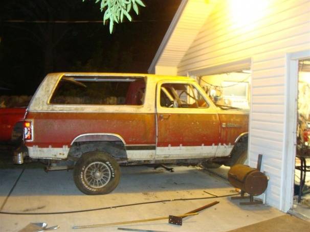

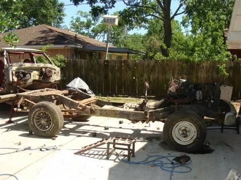

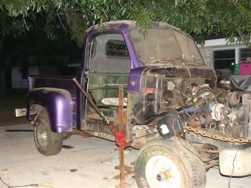

ramcharger 007 (Large).jpgHad this 53 and 383 needed a rebuild and punks knocked the windows out of my Ramchramcharger 006 (Large).jpgarger. So I thought to myself why not? Looking for that grave digger vibe.ramcharger 065 (Large).jpgramcharger 068 (Large).jpg

A very cool move DD, Did you sell the glass that was on the ramcharger ? lol could not resist
How bad does the wheels stick out from where they are supposed to be? I have a 42 Dodge pickup that I am always looking ideas for. I had considered this idea too but I scraped the idea when I measured it out. From your pics it doesn't seem all that bad but maybe a 53 is a little wider than a 42?
53 must be wider because it looks right. Biggest obstacle so far is motor sits back in cab a couple inches and to center steering collumn to one side of truck I will need two steering joints to connect collum to box. Its about a 3 inch offset.

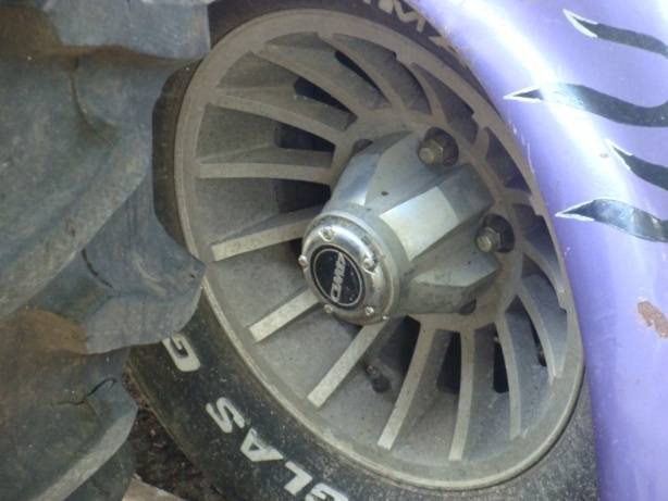

I have the full set and they will be on it. An added plus is the front hubs fit thru them when i take out the center caps
Its almost like theyre meant to be. Im sure you know but those centers and caps arent the best anyways. If they start peeling I would just take them all off and paint the rear axle. They look nice on there though.
