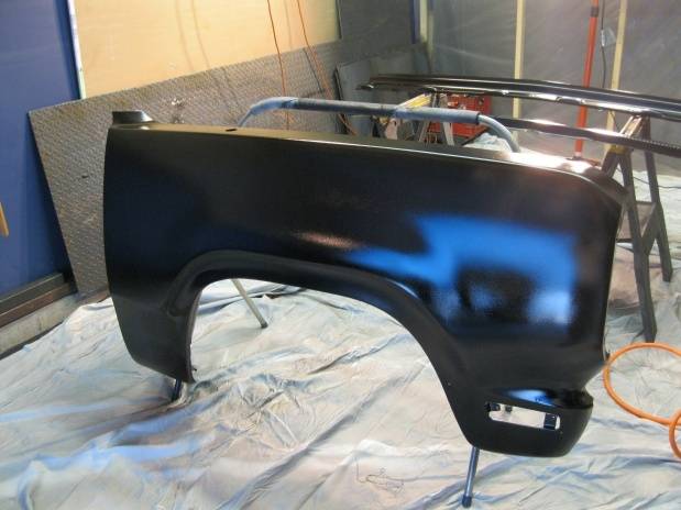

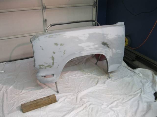

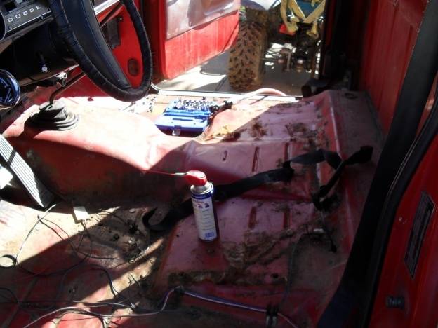

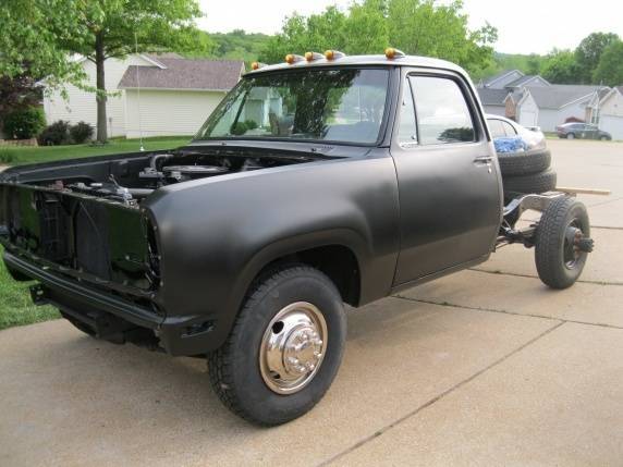

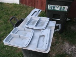

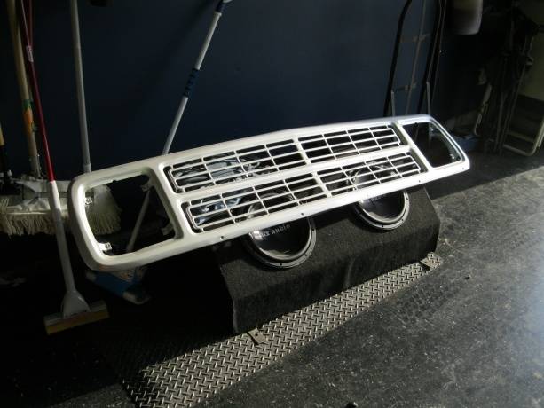

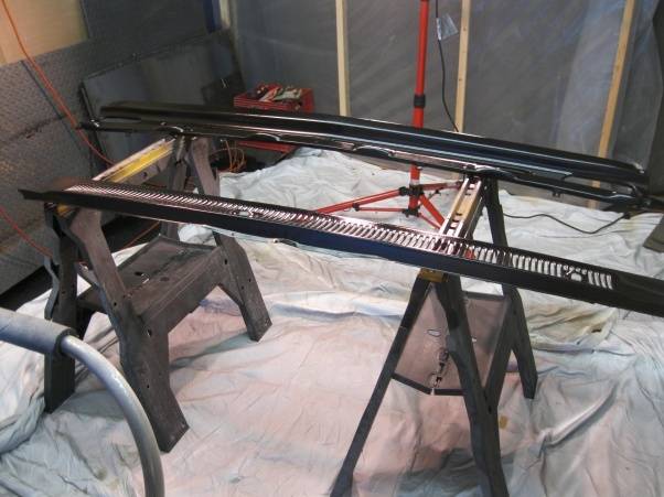

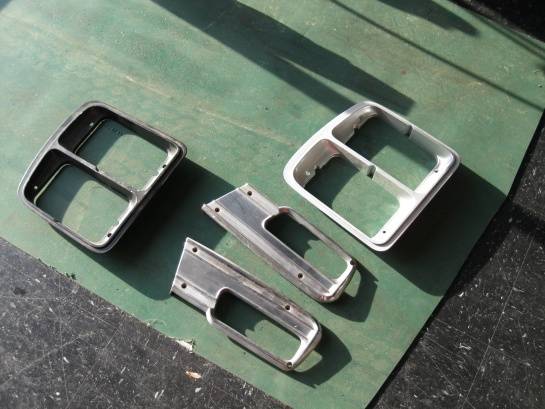

I am working on a 1979 dodge one ton, it was a old farm truck with a lot of rust. The plan was to repair the rust and make it road ready. I could use a truck around the house and to get parts for the a bodies!!! I have missed place the pics before any progress was made so here some of the things i have done.
2009 306.jpgCruise 2012 148.jpgCruise 2012 150.jpgCruise 2012 153.jpgCruise 2012 154.jpgCruise 2012 158.jpgCruise 2012 167.jpgCruise 2012 168.jpgCruise 2012 171.jpg

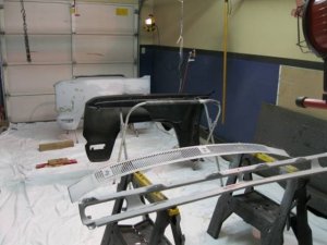

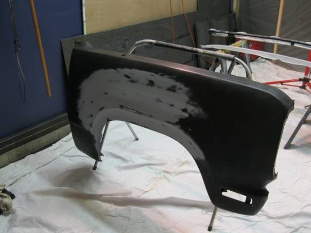

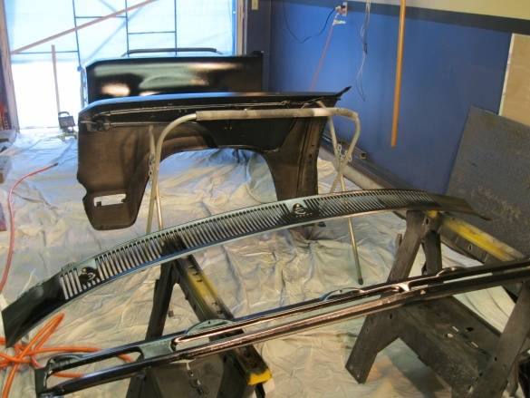

I have the doors and fenders in primer and the pics that i can find of the cab are also in primer more picsCruise 2012 145.jpgCruise 2012 162.jpgCruise 2012 163.jpgCruise 2012 165.jpgCruise 2012 166.jpg

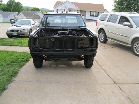

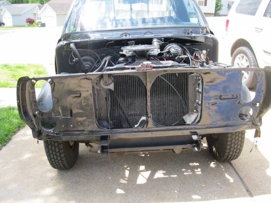

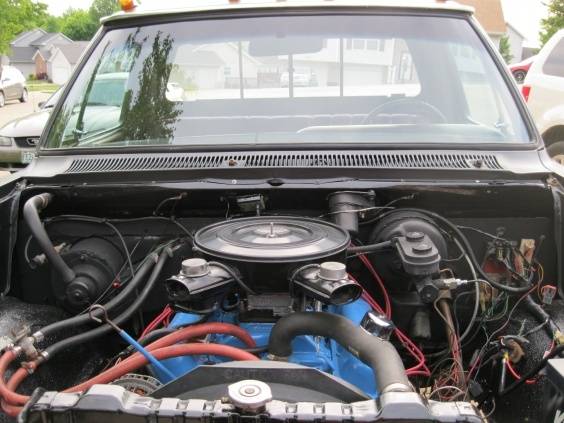

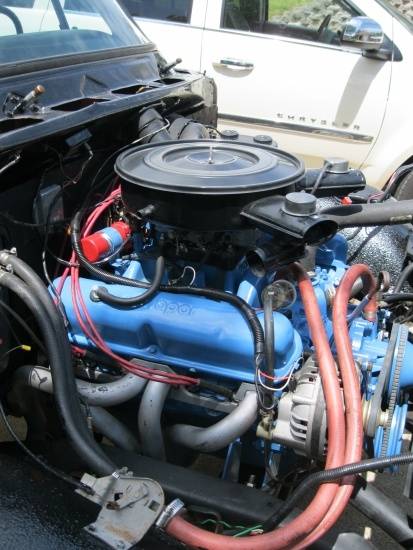

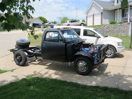

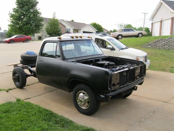

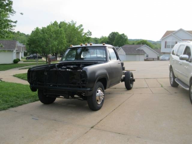

The motor was leaking and had water in the oil. I looked on craigslist and found a 360 in a RV. The owner said they could not find the keys and they have not drove it for twenty years. They stopped driving it after they broke several lugs off trying to fix a flat tire!!! When i arrived at their house i installed a new battery, hit it with starting fluid and after my hot wiring skills it fired right up. 200.00 for the motor and the rear end, 37,000 miles! Once i had it home i installed all new gaskets and a new rear main seal. I installed the motor, the transmission with a new clutch and new shorty headers. some more pics oh and the son needed a hair cut!

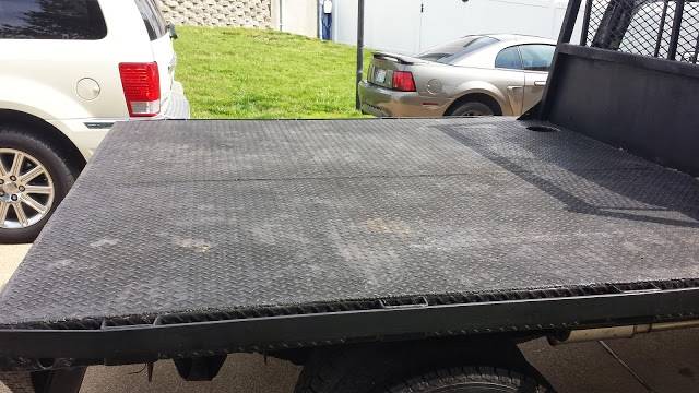

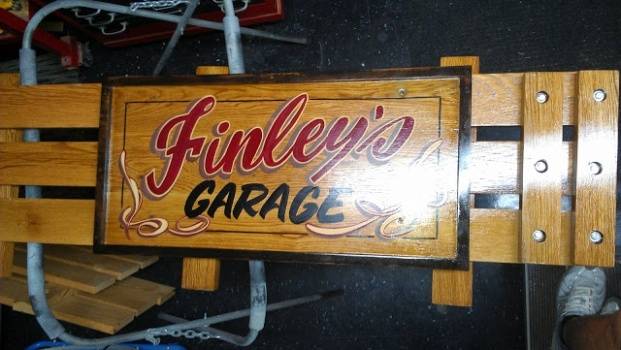

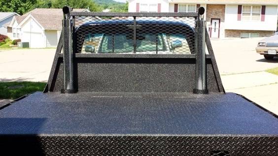

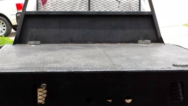

The truck is a flat bed truck. The plan was to install new 1/4 inch steel tread plate. Make new running boards out of oak with old school shop signs. Then new stacks, like the lil red express. The truck is going to be painted two tone black and maroon. I painted a fire tuck last year at work so i am going to use the left over paint. You can see my booth in the back ground of the hair cut. This has taken over two years. The truck is just about done. I will keep downloading pics to get the thread caught up
I guess not much interest in the old truck? Its just about complete. I did all of tne paint work in the garage. Redid the flat bed, along with new oak running board and hand painted old school signs. I am putting a new wire harness in it right now, from Rons wiring. Here is a couple pics.
Dam , That flat bed came out "NICE' ! What did you end up with for the transmission ?
