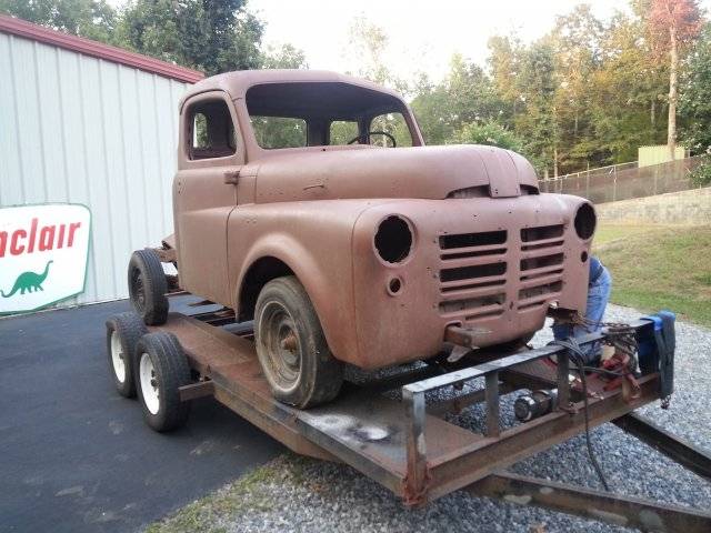

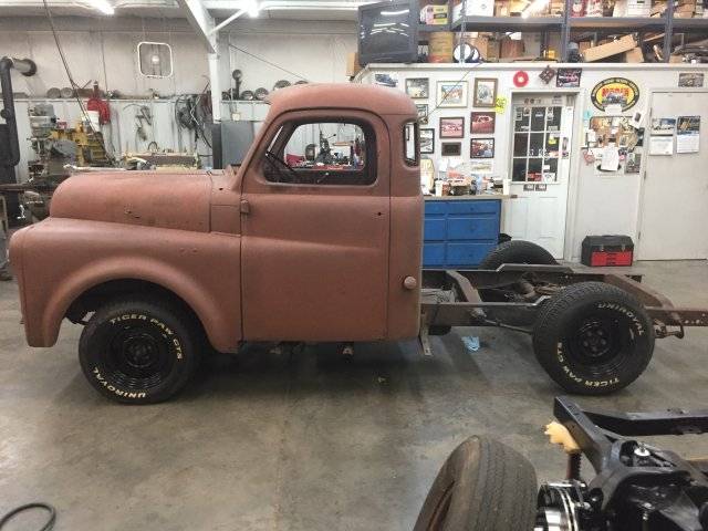

Ok. I'm gonna try my hand at doing a build thread. My project is a 49 Dodge B1. Otherwise known as a Pilothouse truck. This will not be an all original build. So, to the Mopar purist, you can get glad in the same pants you got mad in. I can say that because all I have are Mopars that are all Mopar. I am keeping the flathead 6 which runs as smooth as the murmur of a country brook over moss covered rocks. Lower the ride height (no tail dragger) and maybe chop the top a couple of inches. The short term goal is to get it rolling safely. Long term goal, upgrade and paint the chassis/suspension to get a good ride and have a semi original interior, that's hopefully comfortable. Not painting the cab or bed. This week I picked an 8.8 rear and received the floor pans I ordered from eBay. Today, In preparation for the 8.8 swap I removed leafs from the stock springs and cut the spring pads off the rear. This will be a slow build. The truck is in North Carolina at my dads shop and I live in Florida. Travel back forth every 6-8 weeks. There will be some long gaps in my postings. I am open to suggestions, opinions and sarcastic remarks. I'm a retired Navy MCPO, so I have pretty thick skin. But, if you plan to give me a hard time, prepare to receive one. Thanks all.

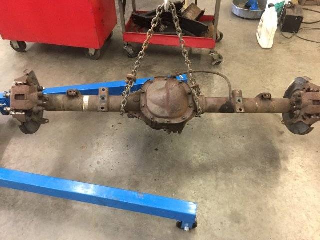

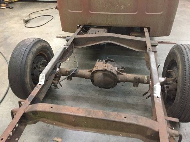

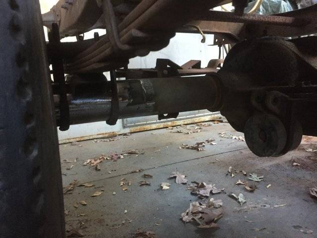

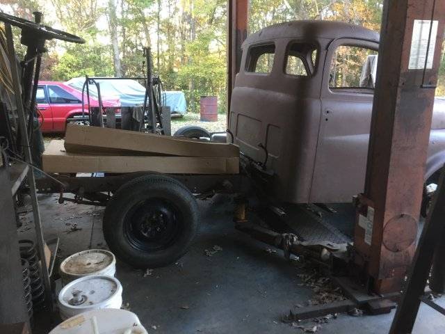

Today, Dad and I temporarily mounted the 8.8. Wasn't sure if the rear would be dropped enough to suit us. Well, it ain't. So, when I come back up in January we will flip the axle and "c" notch the frame. Hopefully in January we can get the front axle removed and mount a Fatman mustang 2 kit. Forgot to mention the trucks name is "Mader".

just wondering about your 8.8 could you tell from which car is it borrowed?. like the idea of the rear disc brakes...

I am also a fan of the 8.8, good choice.

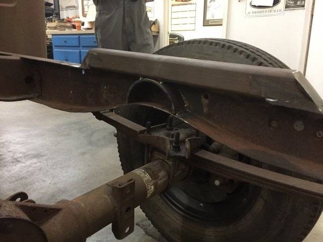

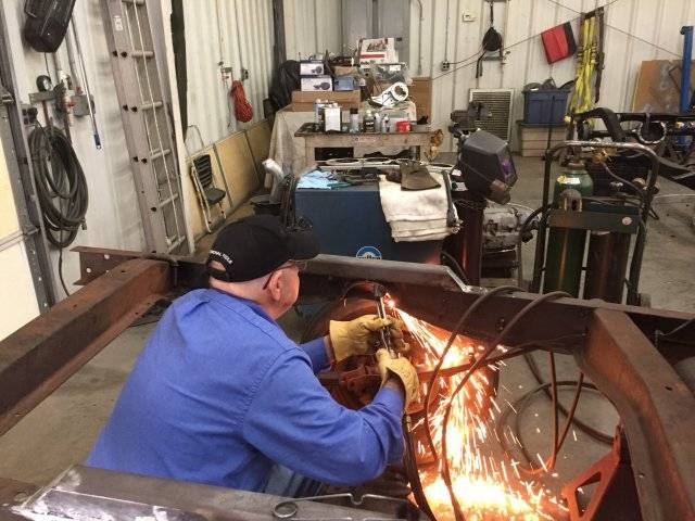

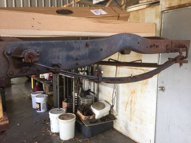

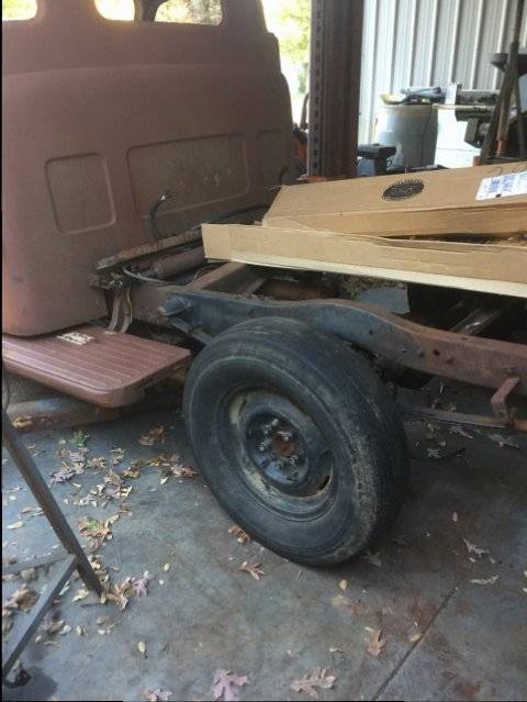

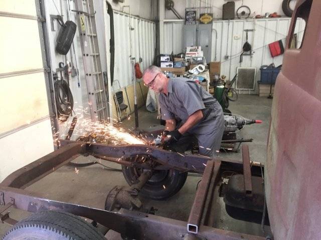

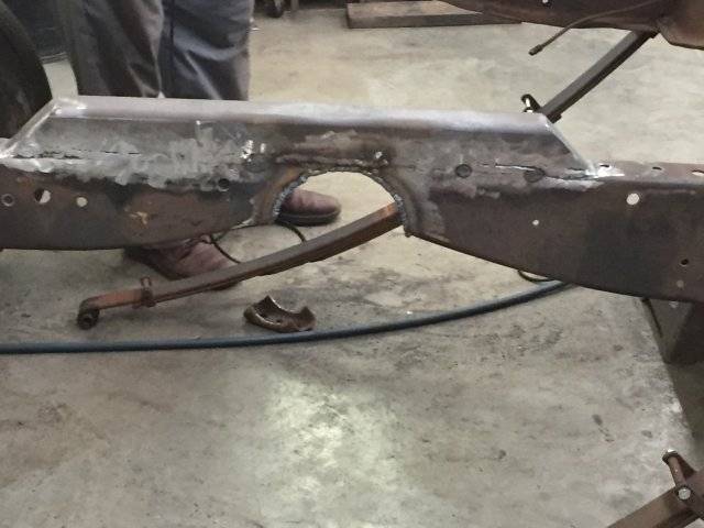

Started dropping the rear this past Monday. Used 2x2, 1/4 inch thick square tubing and a piece of 8 inch round tubing for the notch. Still need to box the frame, make the cross member for the coil overs and build a panhard bar. Haven't decided if I am going to cut the leaf springs and use them as swing arms or make them out of 2x2 square tubing. That's my dad and a friend doing torching and grinding. Oh, I use one of my friends method. It's called MAG technology. Mig and grind.
View attachment 8245 View attachment 8246 View attachment 8247 View attachment 8248 View attachment 8249 View attachment 8250 Started dropping the rear this past Monday. Used 2x2, 1/4 inch thick square tubing and a piece of 8 inch round tubing for the notch. Still need to box the frame, make the cross member for the coil overs and build a panhard bar. Haven't decided if I am going to cut the leaf springs and use them as swing arms or make them out of 2x2 square tubing. That's my dad and a friend doing torching and grinding. Oh, I use one of my friends method. It's called MAG technology. Mig and grind.
You have a crew, lucky! Cool to see some progress on the truck. Keep the updates coming.
It look so easy when it's all ready done !!! you will be lucky with such a crew workingon your side.
