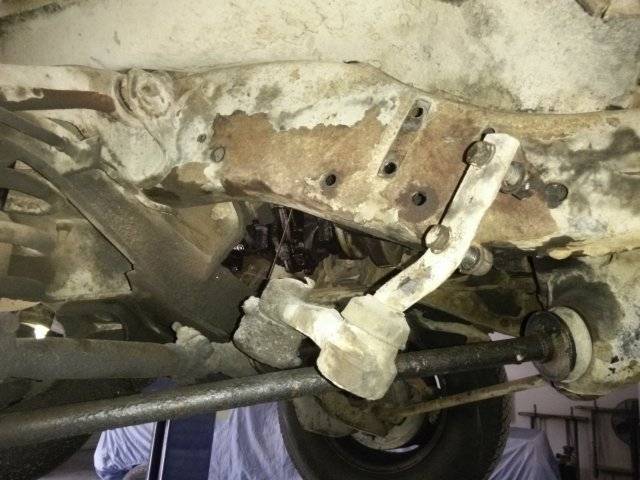

It would have been nice to know that I didnt have to do anything to the engine as far as lifting it, Im glad I trusted my instincts and just dropped the arm that I show in the picture, oil pan had more than enough room to slide out. Ive got maybe an hour into it so far and have removed the starter ( may not of even had to do that technically ) and dust cover and oil pan.
Ive removed 4 out of 5 main bearings, loosened the 5th cap so that its off the seat, not sure what Im expecting, its not gonna drop much in the front cause of at least the chain, not gonna drop much in the rear cause of converter.
Not having any luck still though removing that seal, have tapped with a screwdriver both ends, dosent seem to be moving, only absorbing the screwdriver itself.
Trying to pull on it with the screws Ive put up in there and again its still not moving.
I figured it would be best to get some suggestions.

Im gonna loosen the converter in the A.M Thats gotta give me something to work with if that crank drops down. Thanks
When I did mine I got enough sag just loosening the bearings. Mine is a 4 speed though, but that shouldn't change things except to make it easier for you to loosen up the converter than if I'd tried to undo the clutch.... Good luck with it.
Turned out to be a ropeseal, no way it was coming out like I was trying, unbolting converter still dosent allow converter to go back far enough to disengage crank, have to loosen all trans bolts, slide back trans, drop the crank and go from there.
