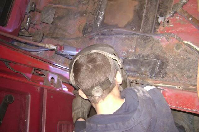

This is my sons "new" driver. He was 16 in July and we have been working on it since Feb or maybe early March. Its been a fun project and it'll be a good first driver for a total investment of less than $1500.<br><br><br>We got it cheap becuase the roof had some pretty good rust issues. so we decided to cut the old one off.<br><br>

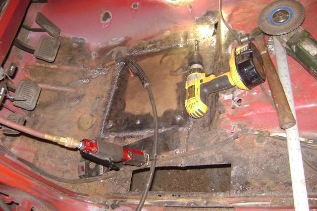

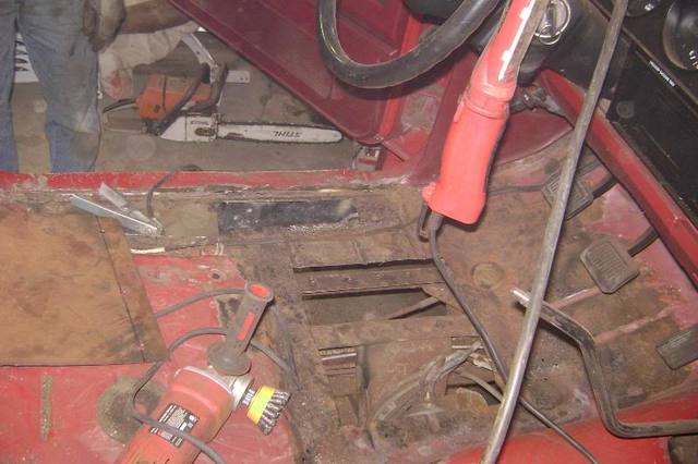

we also found some rust in the floor that had to be removed.....Wonderful learning opertunity!

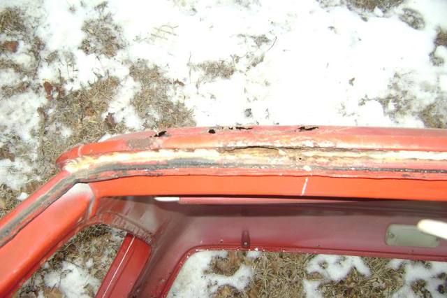

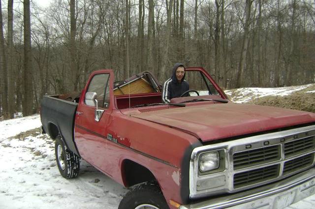

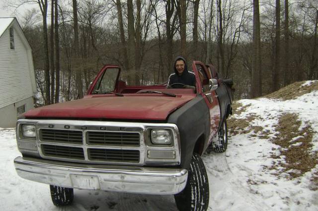

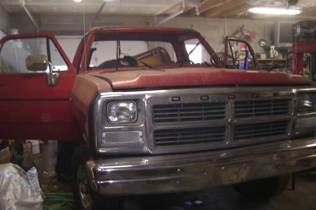

Here's the truck without the roof!!!

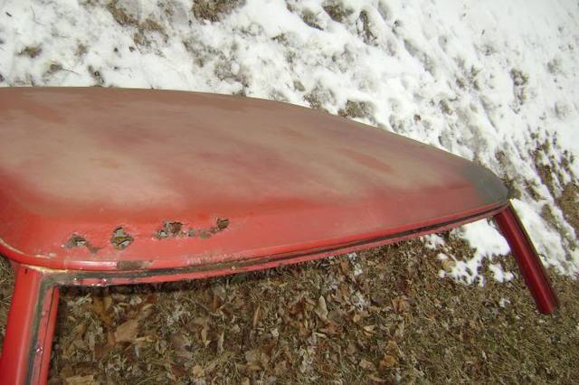

and why we removed it. Its worse than the picture makes it look.
Good to see a young gun in there helping with the work. Looks like a great father son project.
Keep us updated on your progress.

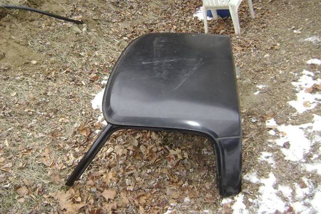

here's a pic of the doner roof. We got from a mom and pop U Pull It for $50.00.
Body work started and almost complete on the cab after the new roof was welded on. I got in a hurry and didn't take or can't find the pics of the roof install.:(

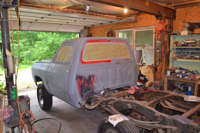

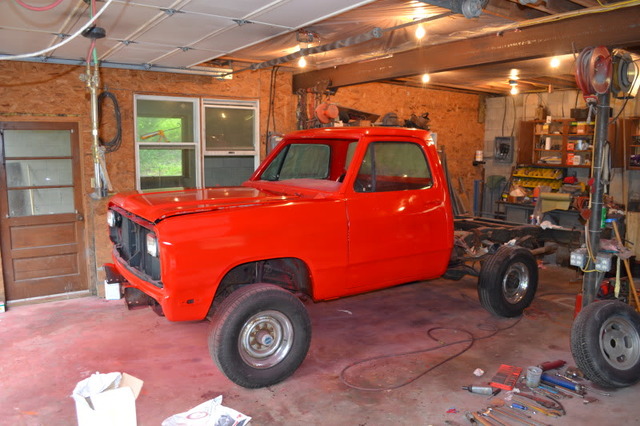

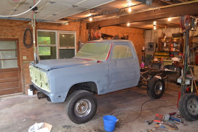

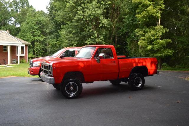

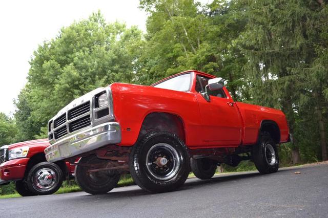

Finally got some paint on it... It didn't turn out too bad for a barn yard paint job!!
The old and the new.........

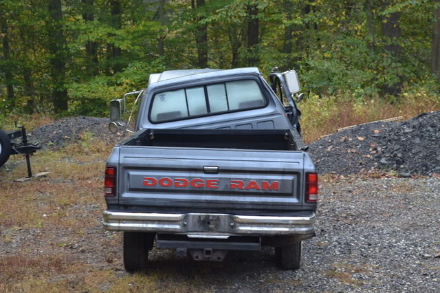

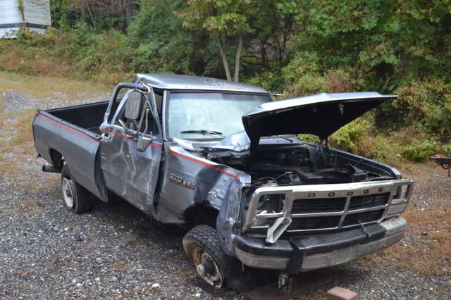

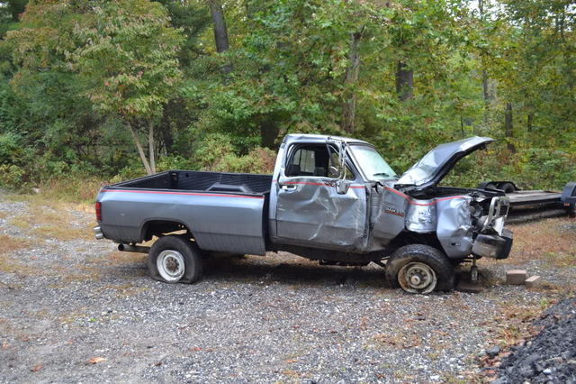

Through a set of very unfortunate circumstances we have been able to aquire a cummins motor and drive train. I bought this truck new in the spring of 1993 and drove it untill late 2006 or early 2007 when I sold it to my oldest friends son. It has been with them until this past Monday. The story goes that the steering" locked up" and he was unable to recover the vehicle before hitting a pole.... Judging from the skid marks looks to his Dad and I that he fell asleep went off the road woke up and over corrected, got himself into a skid and the rest is history.
Thank God that no one was seriously hurt in the wreck. Both young men went to the hospital and were treated for a couple of broken bones and got some stitches but they both walked away!!

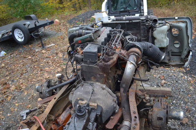

Plan is to pull the drive train and see whats not broke and put it in the 91 short bed.....
Dang !!! That was a hard hit, I am sure glad they walked away from this wreck.

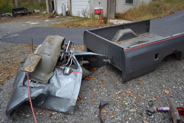

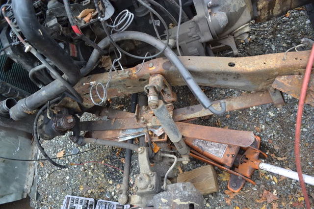

We finally got the 93 torn apart/butchered! Looks like the both motor mounts broke which most likely saved the block from any damage. The only salvageable sheet metal was the drivers side door,end gate and the rear passenger side wheel opening. Everything else had a bend or buckle in it!!
Cross member is bent... Does anybody happen to know if the gad and diesel cross members are the same?
wow that truck took a knock thats crazy. You and your boy have built one nice truck good luck with the swap its gonna be pretty bad when its all done.
The rear axle is fine, I'm not sure about the front one yet. I won't know until I get it out. I think that it might be OK and I'm keepin my fingers crossed ......
