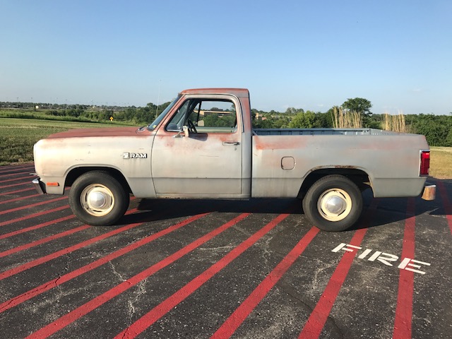

It had some rust issues in the bed sides, driver's rocker and driver's floor pan, but other than that it was a pretty solid driver that just needed a little work here and there. I owned it for about 3 months and did some little projects just to make it road worthy when this truck popped up on Craigslist for the same $2500

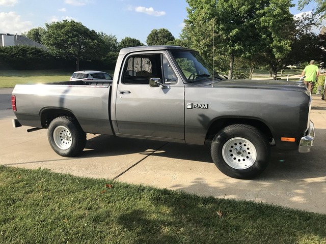

I quickly went and looked at the 84 above and determined that it was a much better starting point for a project. The rust has been repaired and it had a driver quality paint job on it that looks pretty damned good from 20 feet away. Lots of new parts have been added and it has has the same 225/3 speed OD drive train. So I bought it. All of the sudden I owned TWO mid 80's Dodge SWB trucks! I put the first truck back on Craigslist and was able to get my intial investment back after a couple of weeks and a lot of tire kickers. So I'm back to square one with this $2500 truck. Now for the details.

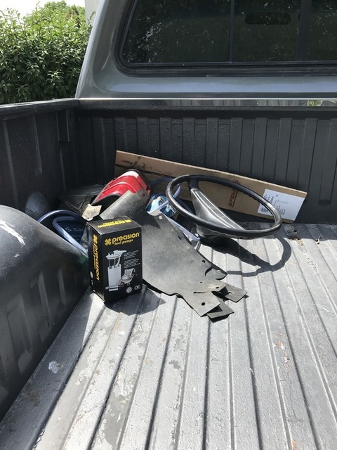

Like I said before, the rust has all been cut out and replaced. The bodywork is mediocre, about what you'd expect from two people working out of a residential garage. The floor pans have been replaced and Dynamat and new carpet put down. The previous owner was a BIG fan of LMC Truck which is located here in Kansas City, because when you open up their catalog, you can see that he bought just about EVERYTHING that they sell for this truck! From the LED headlamps to the new tail light lenses with chrome trim, their products are everywhere. He even threw in a bunch of extra parts that he hadn't gotten around to installing yet including the original steering wheel and a clutch/pressure plate kit which it's going to need pretty quickly.

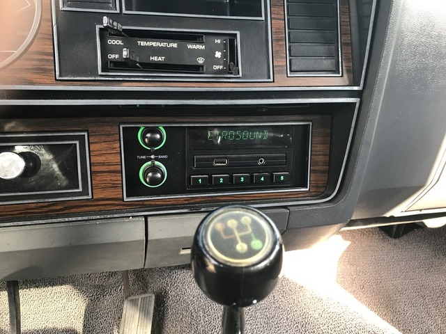

It has about a $600 stereo system in it which includes a RetroSound Newport stereo w/Bluetooth and hands free, two speaker boxes under the seat and two new speakers in the dash. I'm a pretty big car stereo buff, so for me, this was icing on the cake. No need to change a thing.

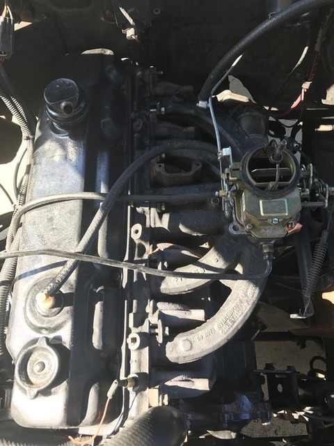

With the help of some other internet friends I'm starting to slowly figure out what is wrong with the truck and hopefully it's a relatively easy fix. The engine is not pulling a strong vacuum and when you pull the PCV hose loose from the back of the carb, the engine continues to idle. I checked for an obstruction in the base of the carb with a small pocket screwdriver and found none. So I guess that the carb is going to have to come off so that I can check for the proper base gasket. Everyone is in agreement that when the PCV hose is pulled off the back of the carb, it should die or at least run very rough. Neither happen. By correcting this, I think I can solve the dip stick tube popping up and also the oil forcing it's way out of the valve cover and oil cap.
The second issue that I'll be addressing is an intake/exhaust manifold leak. The first time I started the truck I commented to the PO that there appeared to be an exhaust leak and he assured me that the exhaust had all been replaced and that there were no leaks. When I showed up two days later to pick up the truck, he had a pile of parts waiting and one of them was a Fel-pro intake/exhaust gasket set?!?! WTH?!?! Turns out the other day when I was diagnosing the PCV problem I did a little more investigating and found that the exhaust gasket is leaking on the number 6 cylinder and the intake has a pretty good leak on the number 1 cylinder. I'm not much of a slant six guy so I did some poking around over at slantsix.org and found out that this is a pretty common problem that can be solved by using GOOD gaskets (not the Fel-pro ones that I have) and by making sure that the mating surfaces aren't warped. There is also a nut and special washer missing off of the number 6 exhaust stud that I'm going to have to locate.

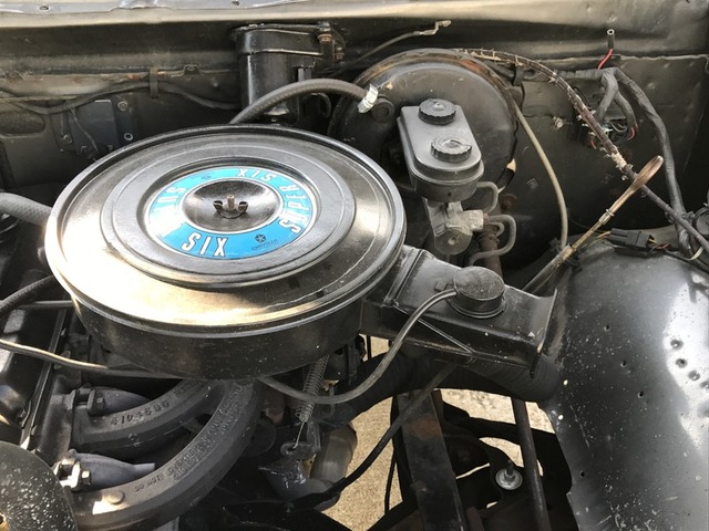

That looks like the single barrel carb. If interested may had access to a super 6 intake and good 2 barrel carb. I am not that far away.
You are close to me and I appreciate the offer, but that is a Super Six intake and Carter 2 bbl carb.

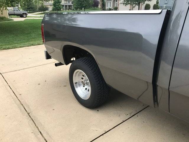

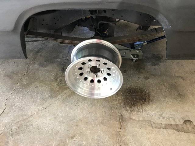

I did some Craigslist wheeling and dealing last weekend and I ended up getting 2 new 15x8 wheels and 2 Cooper Cobra P255/60R15 tires for $50 difference. I had to buy a full set of wheels off a guy and then sell two of them along with my old back wheels and tires. Going to get rid of the farm truck look and start going towards a low street machine look.
Here they are mounted. The lower profile tire only makes the gap between the top of the tire and the bottom of the wheel well further apart. The next step will be lowering the whole truck, but I need to figure out the engine first.
Looks like you installed a lift kit with just a tire swap.
