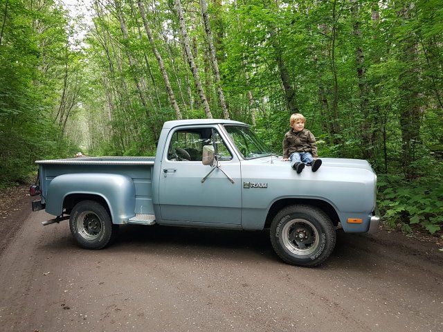

looking into lowering am 84 2wd shortie i just bought my on for his grad . Axle flip in the back with Dakota drop spindles in the front? is this what everyone is doing ? What year of dakota drop spindles should i use ? I ve read 87-90 and 91 -96 are different but yet separate posts show both used. Anyone here have any advice ?
