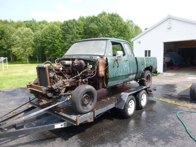

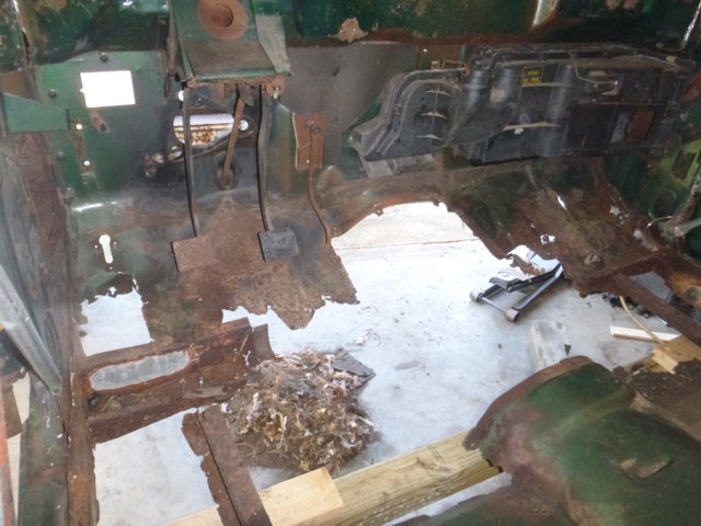

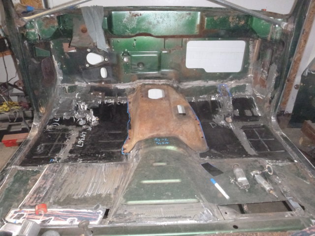

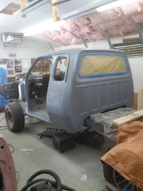

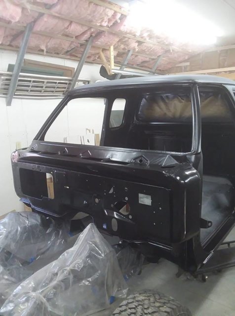

    Getting some more done, finally got the cab in primer and some black on the inside and firewall, been a lot of work to get here.

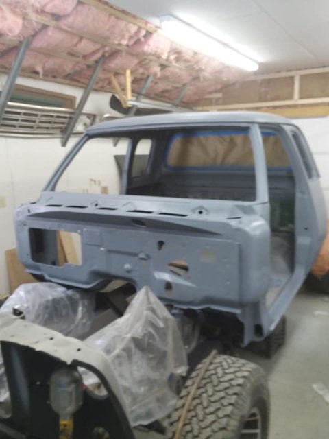

      primer and black!

        Did you end up replacing the whole floor or just the front half?

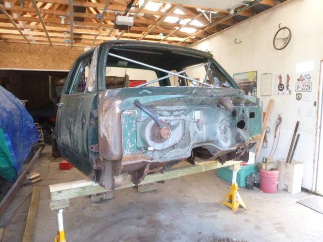

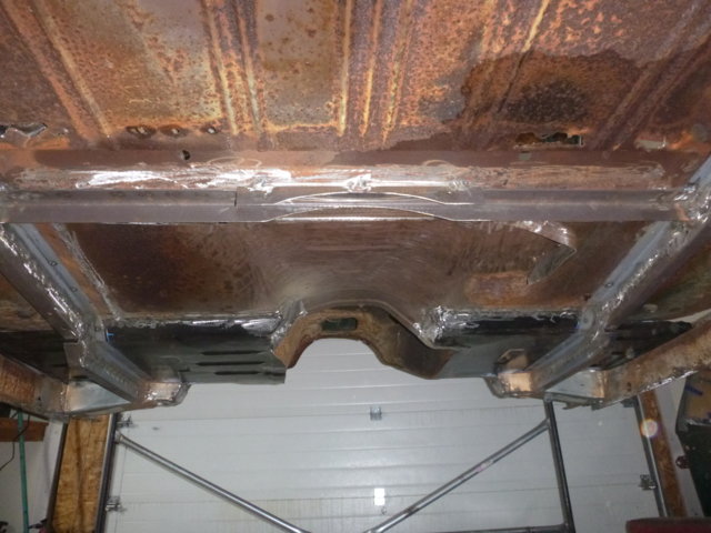

            Both front pans and side pcs for the extended part, they don`t make much else for a clubcab so had to make some pcs myself. I made my own floor supports out of bed frames.

              lot`s of work
