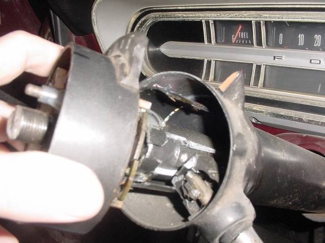

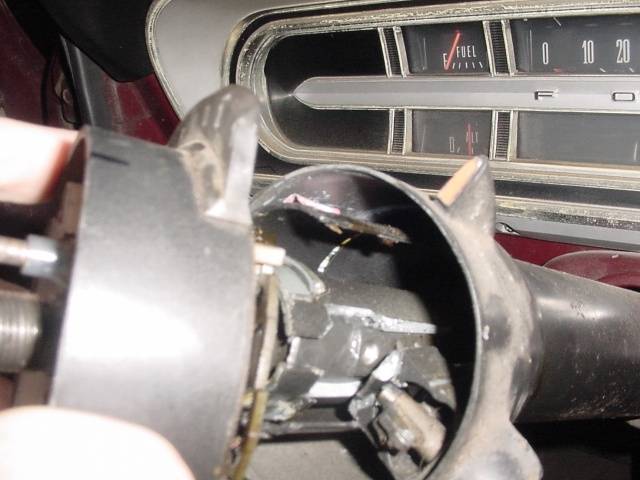

hello, i have a 70' F-100 sport custom ( automatic trans) and need help identifying the name or part number in an exploded parts diagram (LMC Truck). the pot metal component the shift lever connects to inside the shift collar that actuates the linkage, collar is part #23 in the diagram, has sheared off and i'm no longer able to put the trans in to gear.. can you tell me if the part i need is #19/column flange? the LMC catalog isn't that helpful in picturing/identifying the actual part so i've come to you folks for assistance. i'll see if i can post a picture to make it easier to help me. thanks in advance.

good morning, go to the LMC online catalog and search using 'steering column components". #35 is the collar that is broken on my truck. the pot metal fails and the inside portion (pictures) breaks and then you can't select any gears. i sourced the collar thru a local ford dealership. more $$ than LMC. i also bought items #36 (shift lever insulator) and #37 (shift lever pin). to remove the turn signal assem you need to disconnect the wires where they exit lower on the column. fashion some sort of fish wire so you can pull the wire back thru the exit hole. hope this helps.
