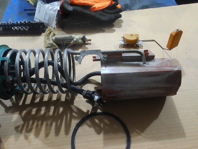

General Information
Going Sniper ignition and carb setup. My question is around the in tank fuel pump. I have pulled the tank and pulled the fuel module. I have replaced the pump with a Walbro GSS340 pump with sock. I pulled the hose attaching pump to model and replaced with high pressure hose. My question is around the connector to the module and do I just clip off the old relay wires and replace with the new relay and wiring harness? I know I need to keep the sender and gauge wires, however, there is one white wire that comes from the loom to the module and it splits into two white wires.
