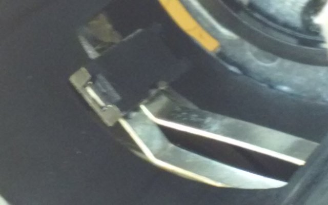

This what the inside of the switch is supposed to look like

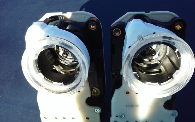

Old switch on left and new on the right. Do not distroy the while installing a new cylinder. New switch and cylinder are working great. No more buzz with lights on.
Maybe I'm missing something, but those look way different. Shadows, must be.
The old one is missing an insulator and bent out of shape. They better look different. Post 4 is what it should look like inside.
Five has the old broken on the left and new on the right.
I never even enlarged the picture! I see what you're talking about better with that second look.
Unfortunately it was an installer error. Have had problems getting it to the auxiliary position and new cylinder fit in the old switch loose. This solved all 3 problems.

What happened is I broke the old switch trying to put the new cylinder in.
