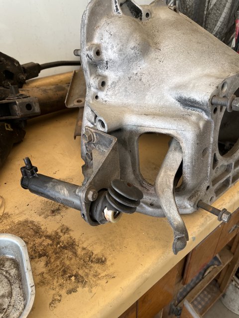

I knew I had one somewhere. This from a 86-87 van. Slave on bell housing. Maybe a 77 don’t remember. Craig
Yup the Bell housing I have also has that.... More wondering about the other end (master cyl on firewall)
I don't remember the fork I got with my pile having that rearward bend
